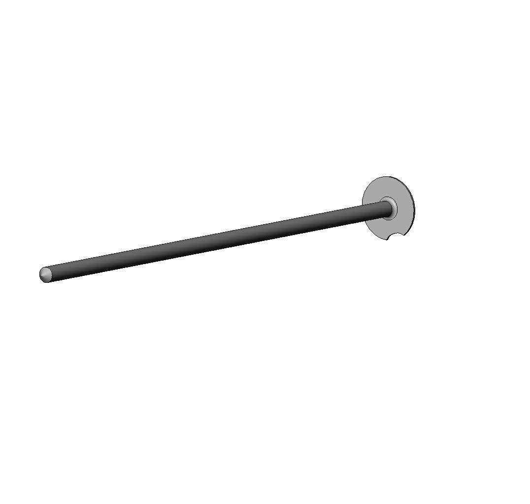

As far as getting the lacquer off of the frets:
I cannot remember where I have seen it, but you can make a nifty little jig out a large penny nail...
1.  run a razor blade along the seem between the fret and the fretboard.  This ensures that you will only chip lacquer away from the fret, and not your fretboard
2.  shape into the head of the nail the profile of the fret - ensuring that it is a little shallow to prevent contact with the fretboard.  Try to add a slight burr - similar to a wood scraper.
3. Scrape the profiled nail head across each fret, and the lacquer should chip off.
I bought a gorgeous aged-cherry burst Fender American Deluxe P-bass a few years ago, and it was nearly perfect - except that there was lacquer all over the frets.  I have to do this process to remove it - and it worked great...

Yep, the nail head trick.  Easiest to do with a roofing nail, big
ol' head and aluminum, which is not so hard that it will scratch up
your frets.  A needle file on the head and Bob's your uncle.
